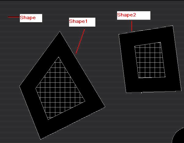

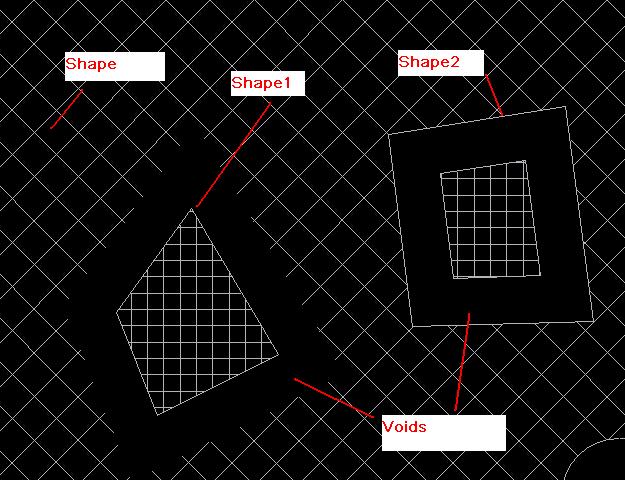

I created 3 shapes with SKILL routine. And I want to change the shape's fill style from solid to crosshatch.
But I met a problem with the voids. Sometimes, some of the old voids are dispear, some of them are correct.
Below is the codes, which I simplified them:
;;Before running the SKILL tool, Shape is filled in Solid, and Shape1, Shape2 are filled in Hori_Vert.
;;Now I want to change Shape's fill sytle with myfill.
Layer="board geometry/test_layer"   ;;The test_layer is an example
myfill1=make_axlFill(?angle 45, ?origin 0:0, ?width 0.127, ?spacing 2.54)
myfill2=make_axlFill(?angle 135, ?origin 0:0, ?width 0.127, ?spacing 2.54)
myfill=list(myfill1 myfill2)  ;;to define the fill style
axlDBCreateShape(car(axlPolyFromDB(Shape)), myfill, Layer, nil, nil); To create a new shape
axlDeleteObject(Shape)
I have tried to use the function: axlDBCreateOpenShape, axlDBCreateVoid and axlDBCreateCloseShape. But it is same situation.
 What is the reason?
Thanks.

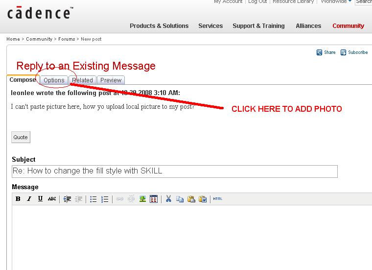

    I can't paste picture here, how yo upload local picture to my post?

    I raised a service request that should have seen this fixed in 16.0.
    I quick test gives me no problems in 16.01.
    You need to write some repeatable code and submit it as a new service request.
     Dave
  • redwire
    redwire over 18 years ago
     See below.
  • leonlee
    leonlee over 18 years ago
    OK, thanks
    The voids is no problem in solid shape.
  • leonlee
    Below is the incorrect one, the voids of Shape1 is disappeared.
