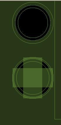

I want to modify the flash type for thermal relief to one of the pad(2nd one) as shown in the screenshot on the brd file, even after updating to the design from Modify-Design Padstack-Single Instance there is no change in the pad on the brd.
Can anybody guide me to modify the flash on the brd.
 Thnx.

     Hi Maac
    I can help you if you can tell me your board is converted from Mentor graphic  board or from Allegro board ?
    You can use file "flash_convert.exe" of Allegro to sole it.

    Thnx for the reply..The board was designed using Allegro PCB Design CIS -L-16.2...where can i find the "flash_convert.exe"  file..

     You can search this file in your cadence in your computer.
    You can do follow file that I attached

    Even if it doesn't work run DBdoctor utility to fix errors. Then try again.
