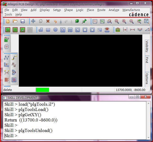

Hello everybody,
 I'd like to get the dynamic cursor location in a program, and take it as a variant. But I can't find the command or solution.
 Is there any SKILL command, which returns dynamic cursor's xy location? Like as AxlEnterPoint or AxlLastPick to get the point data .
Have a good day!
  • yskics
    yskics over 16 years ago
    I had write a DLL plugin and a SKILL file , which work together can REALLY get the current dynamic cursor position. attached is the pixs showing the rusults of the commands. if you think that is what you want, I can post the source code here.

  • leonlee
    leonlee over 16 years ago
    Hi yskics,   It's wonderful, post and share with us.

     hi guys. thanks for your encourage.
     we need the following files:
    1. plgTools.il         : the skill code
    2. plgTools.c         : the c file to be compile in visual studio 2003
    3. plgTools.vcproj   : the project file which you can open directly in VS2003
    4. axlplugin.h        : provided by Cadence, search it in your cadence directory.
    I will post them one by one.
    besides, you should know how to set plugin's directory, please check your ENV file , append the path where the "plgTools.dll" resides, like that:
    # Allegro Plugin search path
    set AXLPLUGINPATH = . $LOCALENV/$CDSPLAT $ALLEGRO_SITE/$CDSPLAT $ALLEGRO_INSTALL_DLL
    E:/SkillPlugin/dll
    the convenient way is to post all the files in a zip file, but the community seems can not post files, so you maybe have to compile the dll yourself. Otherwise I can email the zip file to you.
