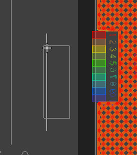

  • DE202408202727
    DE202408202727 over 16 years ago
    It's good to hear that you haven't had problems. I can now discount that as the cause of my problems.I have ages trying to discover why Allegro crashes running my utility. I think the problem may be related to my use of the axlDBCreateSymbolSkeleton command - not the cursor location utility.
    Because Allegro just crashes, I don't get a chance to analyse the problem as well as I would like - and I don't have any memory analysis tools.
    Attached is an image showing the use of my layer window tool. It calculates a "layer window" with one rectangle and layer number for each board layer. Thanks to your utility I can automatically rotate the cursor dynamics depending on which edge of the board the cursor is hovering over. I then highlight the cursor graphics, when a valid location is found, and the user can drop the symbol onto the board edge. It also handles negative layers and eats back any anti-etch lines
    Dave
