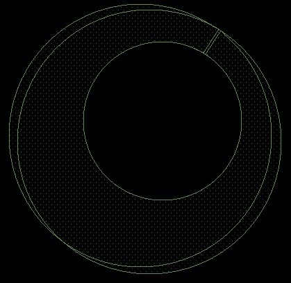

There is a circular shape, which has a circular void, I want to use 1 mil width of the line to cur the void, making the circular shape has no void. Process: the polygon of shape = poly1; the polygon of void = poly2; the polygon of cut line = poly3; Use axlAirGap get the minimum distance between the circular void and the outline border of circular shape. according to the endpoints of axlAirGap result, create the 1 mil width cut line. get the polygon of the cut line (that is, poly3); result = axlPolyOperation(poly1 poly3 'OR); Issue: The graphical result of the combined position is offset. And the original shape is not completely overlap. How should I solve this offset problem? How can i get the right result. Thank you!

    Dear eDave I've attached a picture. As can be seen from the picture is very clear offset。 Thanks Allen

    Hi Allen,
    I don't see where the offset is coming from but I think you should be using 'ANDNOT not 'OR.

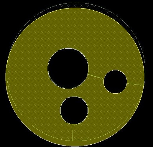

  • YangJinxiao
    YangJinxiao over 14 years ago
    Hi Dave:
    I've changed the centre and radiu of two circle. And then you can see the offset clearly.
    With the increasw in the width of cut line ,the offset will decrease.
    the specific results are given below graph.
    Test Code:
    procedure( test2(dict)
      prog((path oShp vShp vCircleSegment circleShp circleSegment gapData line poly3 poly1 resultPoly)
        path = axlPathStartCircle(list(10000:6000, 50), 0)
        oShp = axlDBCreateOpenShape(path, t, "BOARD GEOMETRY/SILKSCREEN_TOP")
        vShp = axlDBCreateVoidCircle(oShp, list(10005:6008 30))
        vCircleSegment = car(vShp ->segments)
        circleShp = car(axlDBCreateCloseShape(oShp))
        circleSegment = car(circleShp ->segments)
        gapData = axlAirGap(vCircleSegment circleSegment, nil, 'enhanced)
        line = caar(axlDBCreateLine(list(gapData ->location1, gapData ->location2), dict+0.0, "BOARD GEOMETRY/SILKSCREEN_TOP"))
        poly3 = car(axlPolyFromDB(line))
        axlDeleteObject(line)
        poly1 = car(axlPolyFromDB(circleShp))
        resultPoly = car(axlPolyOperation(poly1, poly3, 'ANDNOT))
        car(axlDBCreateShape(resultPoly, t, "BOARD GEOMETRY/SOLDERMASK_TOP"))
    Best Regards
    Allen

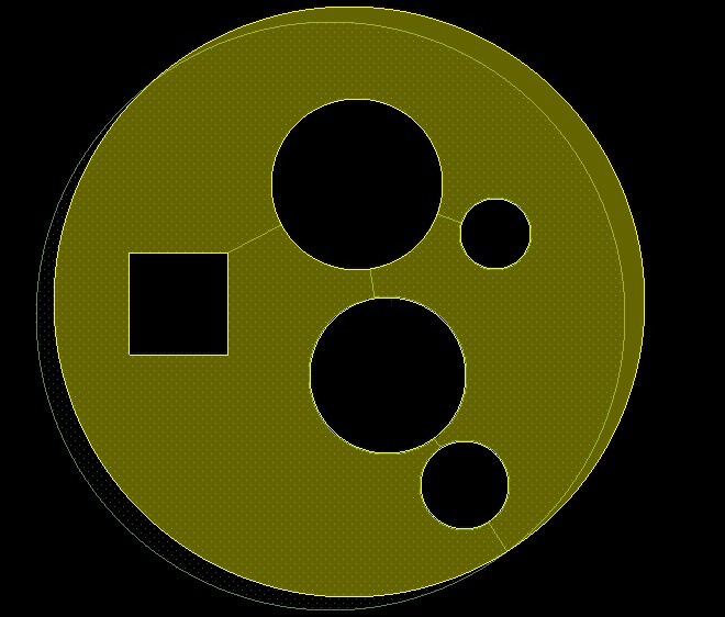

  • YangJinxiao
    The result of test2(2)
