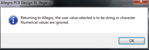

when I enter the below code the output comes breaks and enter the next line, I like to have them displayed in single line.
axlUIConfirm( "Returning to Allegro, the user value selected is to be string or character Numerical values are ignored" )
Thanks in advance,
Nagaraj.

    Hi Nagaraj,
    Which version are you using?
    I tried on 16.5 and I am able to get it correctly as you want in a single line.

    I am using 16.5 S011 version running on Windows 7.

    Hi Nagaraj,
    Try using the highest screen resolution setting in Win7.
    Windows setting is limiting the string length in your dialog box.
