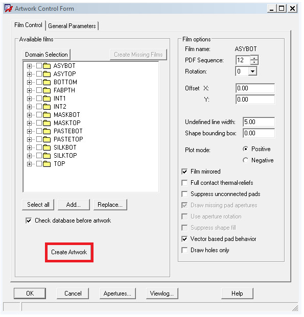

Could someone please let me know if there is an AXL function available for creating the Artwork? shown below.
Thank you.
Sanjeev
  • seyerfred
    seyerfred over 9 years ago
    try axlfcreate
  • kumarsanj
    kumarsanj over 9 years ago
    As per my understanding this function creates only the films. Not the gerber files. Pls correct me if I am wrong
  • seyerfred
    okay, try this one using axlRunBatchDBProgram
    example:
    a = sprintf(nil "artwork -f %s %s" strcat("yourfilm" ".art") strcat(getWorkingDir() "/board.brd" ))
    axlRunBatchDBProgram("cmd" a ?silent t)
  • kumarsanj
    Thank you.
    Below works fine for me
    axlRunBatchDBProgram("artwork" strcat("artwork -f TOP " axlCurrentDesign(), ".brd"), ?noUnload t ?logfile "photoplot.log", ?warnProgram t)
