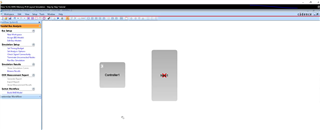

    I am using the same 17.2-2016 version. That is installed automatically with the Cadence software. Is there any other Sigrity tool to be installed?
    I want Cadence System SI Tool as in the attached picture. How can i go there?
