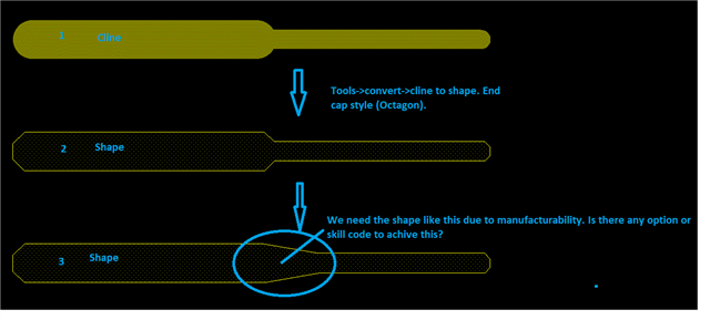

Hi all,
Anyone have a code for cline to trapezoid shape with any angle
Please refer image
Karthik
  • oldmouldy
    oldmouldy over 7 years ago
    Try the Tapered Traces function in PCB Editor.
