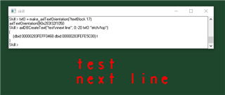

I have a form already made conataining some 'default' notes to import onto drawings. The idea being, you choose which note you require, click on the note and it will be added to your design. This structure works fine as it is. However, one of these text string options is rather long, and I would like it to span 2 lines when imported into Cadence as a result of selecting it in this form.
Here is the line of SKILL:
POPUP,t_misc_line:XXXXX-X WITHOUT MARKING,THIS PCB IS TO BE MANUFACTURED IN ACCORDANCE WITH \015 SPECIFICATION XXXXXX - GENERAL REQUIREMENTS SPECIFICATION,ALL 0.XXMM HOLES TO BE RESIN FILLED AND FLAT PLATED OVER
After the colon, the three options are separated using a comma, forming the list of options that become available in the top window of the form created. The middle option (underlined) is the one I want to span 2 lines when brought through into Cadence.
I have read that using ‘\015’ (in red) is an escape sequence for carriage return, however when using this where it is now, it simply gets brought through and included as part of the text string, rather than splitting said text string over 2 lines.
Please can you offer any guidance on if this is possible and how to accomplish it?
Thanks in advance,
Lewis.

    Try using "\r"
  • LewisHook
    LewisHook over 7 years ago in reply to DE202408202727
    Thank you for your response. I gave this a try and it has the same effect, "\r" just appears within the text string
  • DE202408202727
    DE202408202727 over 7 years ago in reply to LewisHook
    I was over-thinking it. \n should work.
  • DE202408202727
