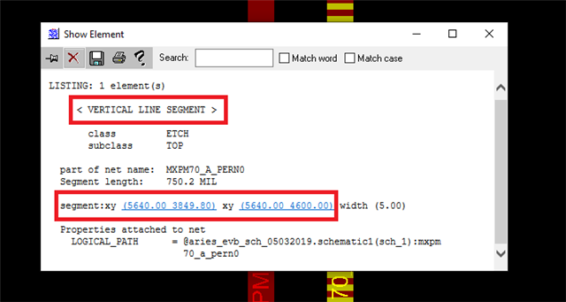

I am trying to get the cline segment report (Net name, cline segment xy location and line segment type). I tried but I don't know the commands to get the cline segment xy and line segment type.
I'll  attach the code below any one please help me to complete this and I will attach the image to.
My code:

    DavidJHutchins over 6 years ago
    foreach(cse CSEG
    if(stringp(cse->net->name) then
    (netname=cse->net->name)
    else
    (netname="not on a net")
    if(eqv(xCoord(car(cse->startEnd)) xCoord(cadr(cse->startEnd))) then
    (orient="Vertical")
    else
    if(eqv(yCoord(car(cse->startEnd)) yCoord(cadr(cse->startEnd))) then
    (orient="Horizonal")
    else
    (orient="Odd-Angle")
    fprintf(writeOutFile, "%s,%s,(%f %f),(%f %f)\n",netname,orient,xCoord(car(cse->startEnd)),yCoord(car(cse->startEnd)),xCoord(cadr(cse->startEnd)),yCoord(cadr(cse->startEnd)))
