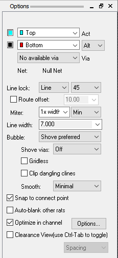

Missing "Replace Etch" in Option window
TiBo
TiBo over 6 years ago
I lost the Replace Etch option in the Option window when I am in Route mode.
Could you help?
Just happen on this design only, the others are okay.
Thanks,
TiBo
  • masamasa
    masamasa over 6 years ago
    in the design parameter editor, you need to check the show on the replace conductor item to display the replace etch option
    you may use the following funckeys in the env file so that you do not need to worry about displaying the option.
    funckey r "add connect;FORM mini replace_etch YES"
    funckey e "add connect;FORM mini replace_etch NO"
  • TiBo
    That works, thank so much
