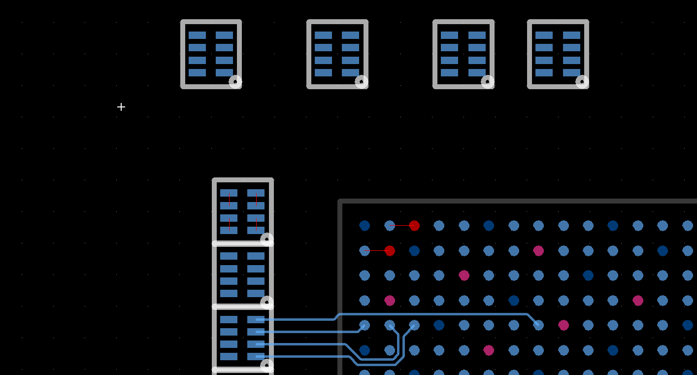

Hi all.
In Allegro/Orcad does anyone know if some skill code exists that would make enabling/disabling ratsnest guides/lines more dynamic ?
In the Specctra route editor I find it far easier to use to enable disable nets than in Allegro.
For example in Specctra you can simply click a pin or window select a component and the rats show up. If you window select a component or pin again that is showing the ratsnest then the ratsnest turns off.
This works great and has been that way for years in Specctra.
Over on the Allegro side of things you have to do two operations basically enable, disable. For example "Show Rats Net" & "Blank Rats Nets"
The dual operation is really tiresome, too many clicks IMHO.
Ideally what I am after is basically a toggle for the ratsnest. Click the pin and the rat appears, click the pin again and it disappears.
It is doable with hot keys but I have too many already assigned Slight smile
Thanks.

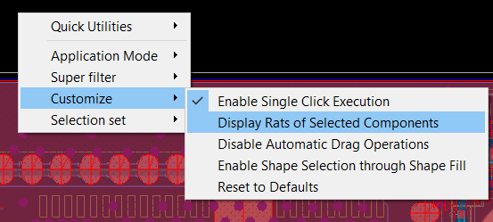

  • RFinley
    RFinley over 6 years ago
    I know about this one as I keep fumbling my macro buttons on my mouse and setting the "Display only ratsnest of selected Component" feature by accident (basically no ratsnest are visible when no parts are selected.)
    Must be in Placement Edit mode>

    Well you can select pins & enable the rat on a pin, It is not necessary to select whole symbols just to see rat lines.
    To put things in perspective all I want do do is. Click a Pin the rat shows up. Click the pin again and the rat disappears or do a window select. The mechanics of how this operation is done in Allegro is very tiresome to use in particular if you are dealing with many components that contain alot of rats nest. I took a look at the skill api and doing rat operations is included so I am thinking having a skill routine is plausible to handle this operation. Skill is not my forte though Slight smile
    If you have access to Specctra try it in that and you will see how easy & fluid rat control is, way way better than Allegro by along shot.
    Thanks.

    Checking 17.2 s064 everything is working at this end. Maybe try the following in order and see if it works.
    1 Go to User Preferences then go to UI > Input and check the box "No_dragpopup". Exit out of the preferences editor and close out allegro.
    2 Extract rats.zip which contains rats.strokes to your pcbenv folder. On my system the path is c:\spb_data\pcbenv.
    3 Go to the pcbenv folder and make sure rats.strokes file exists there.
    4 Go into Allegro
    5 Load the rats.strokes file in the command window using this command      strokefile rats.strokes    If the file is not found or there is a problem info will be displayed in the command window..
    Load a board and enable all the nets so they show.
    Last part is using the actual stroke. Hold down your right mouse button "Keep it held down" and draw a reversed L like in the small video above. Release the right mouse button and click or window select the nets. They should turn off. Doing the same again this time draw an L, release the right mouse button. Window select or click the pins of the part the nets should turn on.
    When drawing a stroke you have to keep the right mouse button held down. Its like draw and release. The stroke should appear in white on your canvas. If the system does not understand your stroke info will be displayed in the command window. It takes a little while to get used to drawing with the right mouse button held down.
    BTW the stroke will default to generaledit mode. So if you were in etchedit mode and drew the stroke it will put your system in generaledit mode. The actual mode can be changed in the stroke file if needed.
    Everything works here. Hope you get it to work. Let us know.
