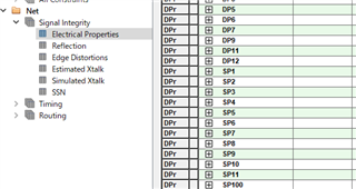

hello
i have set up many differential pairs in the "electrical properties" section on the constraint manager in one design file.
i want the differential pair memership information to get copied to another design file.
i have tried to export constraints from the constraint manager but it did not work.
is there a way to copy the differential pair memership information from one file to another?
  • AvengerThanos
    AvengerThanos over 6 years ago
    You may not be able to export specific information only but you can export entire constraints and import them to the new design. File - Export - techfile this exports all DP pair rules along with all the constraints which can be imported to a new design by File - Import - Techfile
  • masamasa
    masamasa over 6 years ago in reply to AvengerThanos
    thank you for your reply.
    after several tries, i was able to import the differential pair membership information.
    thank you again
