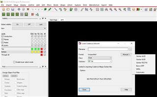

    How do I import gerber files then ?
    If I choose Import->More->Artwork the dialogue has an option for Gerber 274x...
    But the filetypes are *.art...
    The gerber files Im trying to import have extensions such as *.GBL, *.GBP, *.GTL, *.GTP etc
    If I choose 'All Files (*.*) and try to import one of the gerber files I get the following error...
     So how do you import (or view) gerber files in OrCAD PCB ?

    CadAce2K over 6 years ago in reply to johnbbsr
    If these aren't Allegro-generated gerber files, I wouldn't waste my time trying to import them, sorry. Been there, tried that. You end up with a lot of trial-n-error.
