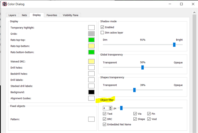

    In case you need it, something to help with unusually large designs and graphics speed.
    "Object filter" removes items from the graphics list by the size of all features.
    If a via or etch segment is less than 4 pixels in size, it is removed from the graphics processor.
  • excellon1
    excellon1 over 6 years ago in reply to RFinley
    Thanks for the tip on the graphics filtering that looks to be handy.

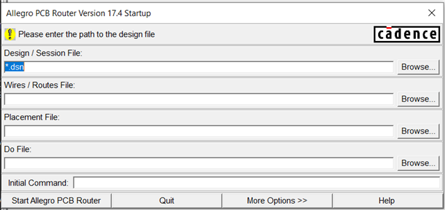

    My install of 17.4 definitely has Specctra 17.4.  Start Menu>  Cadence 17.4>  Router>
