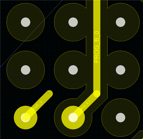

I'm trying to route on an inner layer using bubble routing in hug only mode. Clearance view is set to channel so if I see a gap it should be possible to route through. However, it's not. I cannot route between the holes in the below picture.
If I set Bubble routing to off and simply route through I don't get any DRC errors.
The holes above are 0.2 mm and are 1.0 mm apart. The track is 0.15 mm wide. The grid is 0.1 mm. I have a line to hole clearance of 0.3 mm so I should be able to route between the holes. "Unused via suppression" is, by the way, enabled so the holes belong to vias, that have no annular ring on an inner layer if the via has no connection on the layer.
/F

    So the clearance view shows how much space you have to route and from the screenshot it's clear that the tracks are too thick to fit through the gaps. Try reducing the spacing clearance or reduce the track thickness.

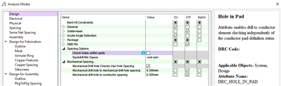

    If I uncheck "Check holes within pads" it works. Which figure is this setting using?
  • steve
    steve over 6 years ago in reply to Fredda
    Sorry - I misread your original email. For the Hole checks default is to only check drill holes when the pads are suppressed. If you enable this it checks it regardless. Have a look at this support.cadence.com/.../ArticleAttachmentPortal. Check your Hole to values in the Spacing.
  • Fredda
    Fredda over 6 years ago in reply to steve
    Thanks, but I don't get it. The via pads are suppressed and thus this setting should not matter in this case. The "Hole to" spacing is set to 0.3 mm, which the clearance view picture in the previous post also reflects.
