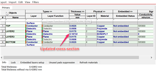

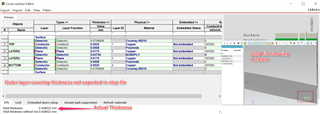

When I export step file ,outer layer (Coverlay) thickness is not added to step file (Refer first image) .Showing wrong PCB thickness (0.28mm) on stepfile.
As a workaround i removed outerlayers from cross section  and added its height to mid layer (as shown in image2) then I got proper thickness on step file .
Anything I am missing here ?. Please suggest ?

    Try adding the layer correctly - rather than as a manually as a dielectric, so right click above TOP and Add Layers then add the Coverlay_Top above. Take a look at www.youtube.com/watch about 3.50 shows you this.

    Thanks for the hint .I did cross section setting same as its shown in the video, but in step export mask layers are  not added
    i have attached test board file (with cross section data) and its step file , could you please help me to find out the issue

    You may need to confirm this with Cadence Online support but I think the issue is because Coverlay is a Rigid Flex class and the board you have sent is a standard stackup. If you create a Flexi section (zones) on your board then the coverlay does show up. You do have to draw this on rigid flex / coverlay_top layer for it to be shown though.
