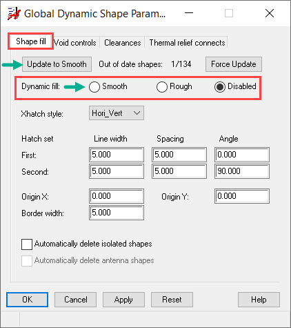

I’m learning with Allegro PCB Designer tutorial.  Creating a Shape for the VCC Power Layer, isn’t working as stated. Prior to the operation the DRC flag is Green. Yet, as soon as I complete the following operation the DRC flag turns to Red.
·         In mode Etch Edit, no selection
·         Shape > Polygon
·         Set Active Class ETCH and Subclass VCC
·         Set Shape Fill type to Dynamic Copper.
·         Browse and select VCC as the assigned NET
·         Use mouse to create the polygon on the board
·         RMB Done
·         Tools > Update DRC
A very straightforward Operation. Yet, as soon as I Update DRC the DRC flag turns to Red. If I run Tools > Quick Reports > Design Rules Check (DRC) Report I get a blank report stating Total DRC errors zero 0. If I run Tools > Quick Reports > Design Rules Net Shorts Check (DRC) Report.  I also get a blank report stating Total DRC errors zero 0. If I delete the newly created shape, and re-run Tools > Update DRC the flag return back to Green. I also tried to create that shape on an empty are with no packaged, same result.
Can anyone help me understand what is going on ?
What could be the cause for that strange DRC flag yet no reported DRC error ?

    Sounds like you have Shapes disabled in the design.  Check Global Shape Parameters to make sure Dynamic fill is set to Smooth.
    • Shape > Global Dynamic Parameters under the Shape fill tab
    • Change Dynamic fill to Smooth and click the Update to Smooth button.

    Spot On Mike Catrambone. Thank you so much! Worked in a snap. Now I have to figure out why I and when did I go there to change that parameter.
