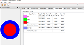

  • Lennie
    Lennie over 6 years ago in reply to Cailloux
    If you select the pin C22.2 / right click  mouse button / modify design padstack/single instance the padstack editor will come up. Look under design layers and you will see the outer layers are 54 and the inner are 36. They are the same size as the drill.
  • Lennie
    Lennie over 6 years ago in reply to Lennie
    Here is a picture.
  • CadAce2K
    CadAce2K over 6 years ago in reply to Cailloux
