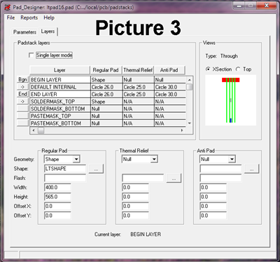

Picture 1 show a Shape created in Allegro PCB Editor 16.6, file LTshape.ssm      The Shape Origin is dead center of the outline 565X400 mils.    This Shape is utilized in the PadStack Editor to create a special Pin for a custom Footprint.

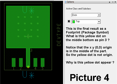

Picture 2 show the PadStack Editor first page with drill size and offset. File  LTshape16.pad         Picture 3 show the PadStack Editor page 2 with that LTshape utilized as the BEGIN LAYER for copper area. Picture 4 show the actual Package (footprint) finished with Outline, padstacks for pin 1,2,4,5 and that special Pin 3 LTshape. Its origin is also dead center, same as LTshape.ssm
Notice the round dot at the bottom of Pin 3. It only appear in the Package drawing, not in the original Picture 1, the actual LTshape.ssm or LTshape.dra
Picture 5 shows that same Footprint in the final board in PCB Editor. That same dot, now pink, is still there and cannot be selected separately. When using the Find Option and selecting each object separately, the only way to select Pin 3 is when Option > Pin is selected. Then I can hover on the dot near Pin 3 and the whole LTshape lights up as pin 3, but not the pink dot. There is absolutely no way I can select that dot as an object. There is no way to know the existence of that dot except by looking at it. Cannot be deleted, cannot be selected, can only be invisible if I use the Color Visibility manager and disable all 4 layers, TOP GND VCC BOTTOM. If I turn On TOP then the dot becomes pink. With GND On the dot is green, VCC On will get a Red dot, BOTTOM On will not show the dot but Pin 3 turn On since LTshape is the actual Net connected. This Net is not GND nor VCC, it is N357726.
Where is this dot coming from and why is it not a selectable object ? Why can I not delete it ?

    steve over 6 years ago
    So this will be the pad that you defined on the Bottom / Default Internal layers. The drill array you define is only for the drill holes. You can't define a pad for the drill holes like this. If you want to do something like this then the pad must be the same on all layers or you will just see drill holes with no pads on inner and the bottom layers. The better way to define this is place the SMD pin in the footprint then use Layout - Connections and double click to add a via. You can then copy this via to the locations you want. If you want to setup wish via you look at go to Constraint Manager - Physical and define the via there for the DEFAULT rule as you would in any board.

    Cailloux over 6 years ago in reply to steve
    Spot On Steve ! I changed the Pad Geometry for both INNER and BOTTOM and found that it is the BOTTOM part of the Pad that shows as that dot.
