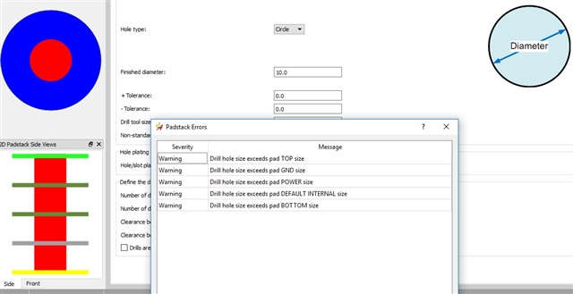

Greeting to all:
I am new in this tool, only 2 weeks. Trying to create a new Via with smaller size drill hole from exiting 13 mils size to 10 mils size. I got the message as imaged below. Any advise what to do?  Thanks in advance.
  • AvengerThanos
    AvengerThanos over 6 years ago
    for instance, if pad is 10mils and drill is 15mils you get these warnings. usually, it is expected to have pad size larger than drill size
  • SART
    SART over 6 years ago in reply to AvengerThanos
    Greetings to you. Many thanks AvengerThanos for your kind reply. I got it. Only concern is that in this case, I was reducing the drill size from 13 mils to 10 mils keeping pad size same. I will try again. Thanks again.
