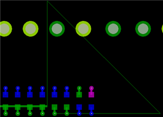

I am getting problems since we have upgraded to ver 17.2. Nets which are close enough or we routed a net to close location and left it unconnected, it should show a small line just like old versions did but in 17.2 straight rats are converting to big triangular type lines. It is causing problem when we have so many closely placed components connecting each other.
Please Help.

    Have you tried Setup > Design Parameters... > Ratsnest geometry: > Straight ?

    Tanveer over 5 years ago in reply to joma
    Thanks joma, really appreciate your help. It was very annoying for me.
    Thanks again for quick help.
