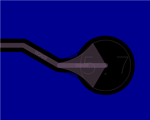

    u may try this.
    let us assume u have the following design on L3 of a 5-layer design.
    temporarily u need to make the cline wider on L3 for the openings of L2 nd L4.
    then u convert the cline to a shape.
    u can convert it to any unused conductor layer temporarily.
    the shape can be copied to the route keepout layers of L2 and L4.
    do not forget to put the cline back to the original width on L3.
    the image below is L3 and L2 overlaid.
    u may need to add a circular shape on the route keepout layers around the padstack.

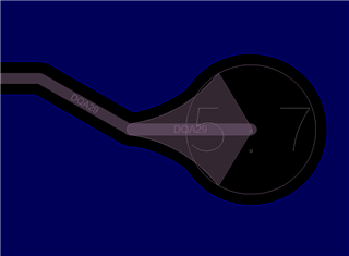

    the below is L3 and L2 overlaid.
     u may want to adjust the fillet more.
    if u have multiple clines, u do not have to do them one by one but do them all at once by following the steps above.

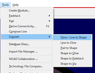

    Thank you for replying, I don't seem to have the convert tool on my version. Is it only within the Tools Tab or is it because of my version of OrCAD?

    if u do not have it, u can try this skill
    u can download the zip file.
    https://community.cadence.com/cadence_technology_forums/f/pcb-skill/7407/axlskill-function-to-convert-a-cline-to-a-shape
