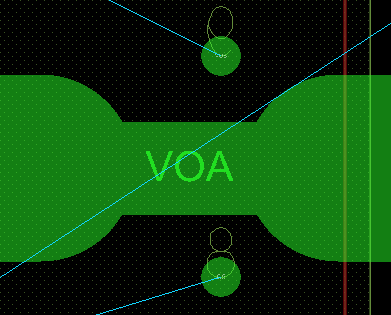

Hello Experts, I am using OrCAD PCB Designer Standard 17.2. I am routing a power line through between 2 narrow pins, like this:
I want to route the line like this, how should I do?
The idea is to create a PCB keepout for these 2 pins and a route for the line to go straight, but I don't know how to do it. Please help me. Thank you very much.

    joma over 5 years ago +1
    You could add a rectangle of dynamic copper. Traces don't change their shape in the way that you have drawn. Jim O'Mahony

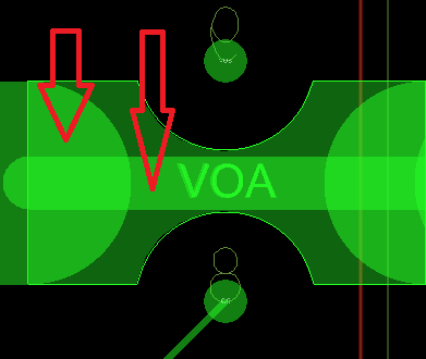

    I'm done  by using dynamic copper. Thanks Jim O'Mahony. But I wonder if the thickness of the copper that intersects the dynamic copper and the normal routing line is doubled when making a real board?
    I really want its thickness to double.
