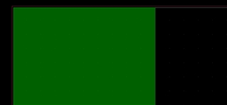

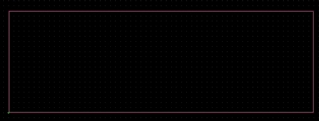

    So to help with this the first thing is you need a board outline, I assume you have this. Inside the board outline create a route keepin all with a shape on the route keepin class.subclass.
    Make this shape 300um away from the board outline.
    Here is a pic.
    The grey rectangle is the "Keepin" Basically this keeps all routes etc a certain distance from the edge of the board.
    The next pic shows what happens when I add a shape that extends beyond the board outline.
    Notice that the copper does not extend beyond that keepin. I think this should resolve keeping the shape a set distance from the edge of the board.
    The other thing to consider is the actual traces. You want to have a rule that keeps the traces a certain distance away from the shape. This can be done on a net basis with the CM using the
    "Spacing constraint set" > NET > Line to shape spacing. In here you can set a distance how far you want a line away from a shape.
    You can also use the global rules for a shape instead of setting a net rule. Normally each shape has certain default clearances that are defined in the CM under "Spacing constraint set"
    all layers.
    When you pour the shape use a "Dynamic Shape" and assign it a net.
    I think the best method to do what you need is put your traces/clines in first then pour a dynamic shape and assign it to a net "GND"
    One thing, You mention you want to put vias on that 300um copper strip above the traces. 300um = 11.81 mil. This is fairly small. Typically if you use a mechanical drill the smallest hole size is about 6mil which should be do-able, but you don't have much margin for breakout 3mil !!!, Possibly you may need to resort to a laser drill hole to make the hole smaller.
