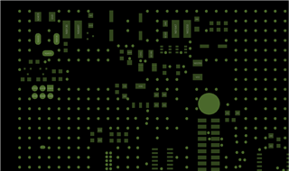

I want to create gerber files. As per some videos I've seen on a popular video streaming site, I created the standard gerber files for a 2 layer design.
Here is what was suggested :

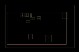

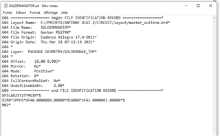

I thougth I would have everything I need with this. For now, my main concern is in regards with the soldermask. The generated file does not contain any valuable information. See:

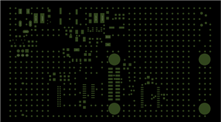

In OrCAD, when I turn on only that layer, this is what I get :

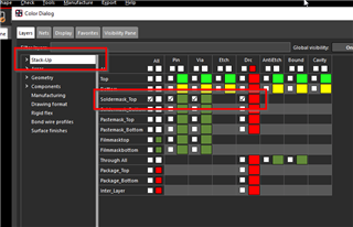

Only if I choose that different layer in the Color menu I can make the soldermask to show proper information
Unfortunately, "Stack-up" is not part of a Class/Subclass thing.

    Got it !
    Need to select
    PINS/SOLDERMASK TOP
    PINS/SOLDERMASK_BOTTOM
    Let me know if I'm wrong...
