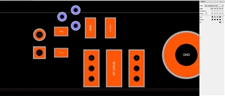

Hello everybody,
is it any way to ON/OFF the Drill layers?
E.g. like funckey 1 'settoggle lay lay_top lay_top_nil; $lay'
1 is TOP
2 is BOTTOM
5 is DRILL Layer (Vias only)
Is the command like  'settoggle lay  Drill Drill_nil; $lay' available?
Best regards
  • excellon1
    excellon1 over 5 years ago
    Hi JuriV.

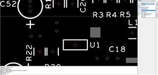

    I find using the "Color View Save" under the View menu somewhat better than assigning macros to keys, maybe faster too. You also could use a macro to call the particular color file too if you wanted.
    Here is a pic to explain.
    So to do this just turn on the layers you need. For my drill I also include the silkscreen so it is easy to identify where the drill holes are on the board.
    Steps.
    Enable the layers you need. For the drill it will be. Board Outline & NCLEGEND-1-2.
    If all looks good go to View Menu and use Color View Save.
    Enter a name, for this I use simply drill.color.
    I typically save these color files to the Root Cadence folder.
    In the Visibility pane you can see the color files show up. All you have to do is select it and your saved views will show up. In the pic you can see I have a few
    views so with one mouse click I can enable the view I need.
    Here is one more pic showing the top solder mask to give you an idea of how flexible it can be.
    All the best.
