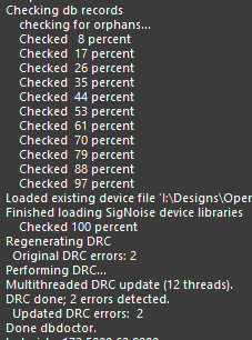

    Thanks for answering. Tried that and it reported: "Deleted 7 FIXED properties.". However, I still cannot select the clines. If I only select Nets in the FInd window and click on a GND cline, the "unselectable" clines are highlighted so it seems like they belong to the GND net. When clicking directly on the "unselectable" clines nothing is highlighted.

    OK Try a Tools - Database Check (or Check - Database Check if using OrCAD licensed tools), click all the options and click on Check. You can also try a Route - Gloss, set the parameters for Line Smoothing and run that.

    Tried the dbdoctor, but still not selectable.
    Show element doesn't reveal anything.
    Route - Gloss and Line Smoothing worked however! The clines got deleted. Any idea what could have happened?
