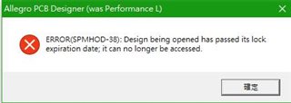

There's an error when I open brd file : ERROR(SPMHOD-38): Design being opened has passed its lock expiration date;it can no longer be accessed.
LuluW
LuluW over 5 years ago
I'd successfully opened the brd file before, but it shows error now when I open it.
It shows "ERROR(SPMHOD-38): Design being opened has passed its lock expiration date;it can no longer be accessed."
How could I resolve it?
By the way, it is the locked brd file which need password, I've no idea if it related to the error.
Much appreciated!
  • steve
    steve over 5 years ago +1

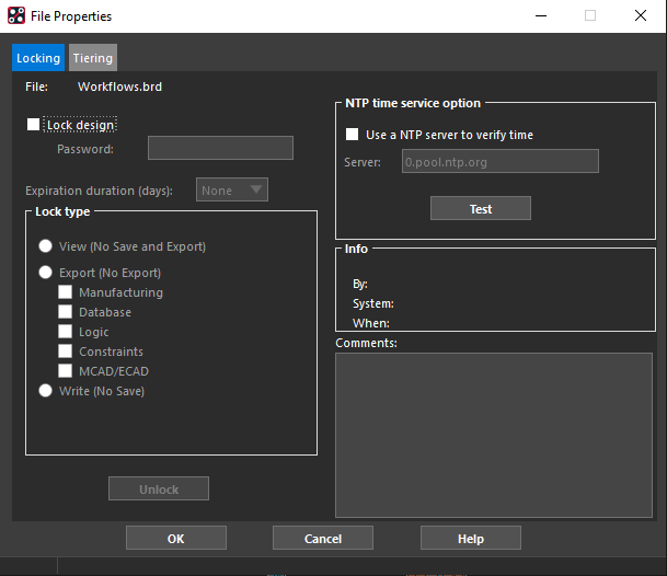

    So the owner of the board has set a password and a time limit and that has now expired. You'll need to contact them and get a new version of board.

    LuluW over 5 years ago in reply to steve
    Steve
    I'll contact the board owner, thanks for your help.
