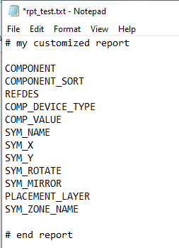

Hi All
I tried to generate cusomized report refer to "Extract UI" window with text editor...
but there is no any "find" function so it's hard to find the code that I want.
so is there any document or datasheet to easy to find the parameters?
regard
