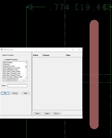

    Item 1 - Please correct me if I am wrong this, but is there not a constraint in spacing for holes?  Please note I am still in Rev 16.6

    Can this not be applied individually to Different PCS (Physical Constraint Sets)?  We normally create PCS based on Voltage ratings.  Example Level 1 = EN90650 first level of spacing, then Level2 etc.  Also is it possible to assign a clearance property to a single (or multiple) Mechanical pin?

    Sorry for the Typo (not enough coffee), I meant the SCS (Spacing Constraint Set) Disappointed, once again there are spacing rules for hole to line, pin, via, shape and hole.  I have attached a screen shot from my 16.6 Rev of a mechanical slot with the properties options shown.  Would this not also work?
    5KV creepage hole.
