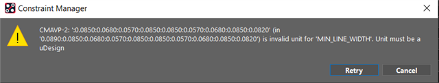

My Allegro .brd was originally done in 17.2. We moved to 17.4, engineer made changes that somehow wrecked some trace width constraints. When I open CM and try to correct them, I get this message:
All I need to change is the 0.0820 to 0.0890 and I don't understand the message. Yes, I've tried the max width first, but still get the same message.
Any feedback would be greatly appreciated.

    Try run a database check on the design to see if anything shows up first. It looks to me like some corruption exists with the design.
    If you cant resolve this maybe go back to the prior design in 17.2 and do a DB Check there. Then open the design in 17.4.

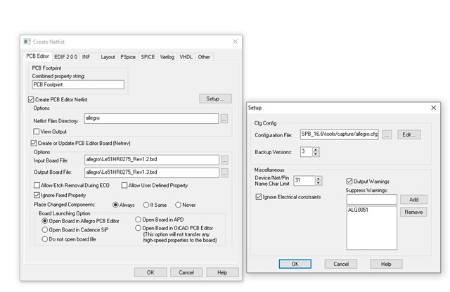

    Using Capture. The PCS changed to default for a group of nets. The engineer says he didn't change anything in properties, so it's odd.
  • Wild
    Wild over 5 years ago in reply to ameehan2
    I have had the issues over the years when I output a netlist from Capture to Allegro my constraints would changing in Allegro.  The simple solution I found is to disable the ECS export during netlist.  Example attached.  However, I have found a belt and suspends approach: in Allegro, once I have all my constraints set the way I want them, I export the constraints to a dcf file in my Allegro directory.  So when I screw up, or a coworker who hates constraints deletes them, I can recover the constraints. Slight smile
