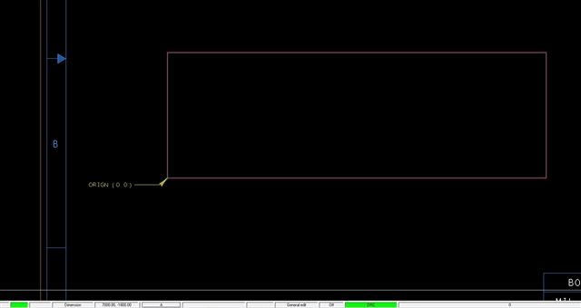

    First thing you need to do is draw a "Board Outline" for the size of the board you need. To practice things it can be any size you choose. When you get the board outline drawn you next need to set the origin point of the board. This is done using "Change Drawing Origin" which is under setup. Click on that and then click the bottom left corner of your board outline. This sets the absolute origin of your board to be 0,0 in the bottom left corner of the  board.
    Here is a pic.
    In the picture you can see the board origin. That is the green marker. In the bottom of the window you can also see the current cursor location and a button marked "A". This button toggles between Relative and absolute coordinates.

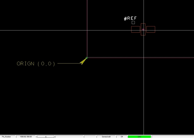

    Go ahead and select a part for placement so that it is on your cursor. Don't place it but move it around inside your board outline. Notice how the X,Y coordinates change. What this is telling you is that that the "Origin Point" of your footprint
    is an absolute distance in (X,Y) away from your board origin.
    Another picture.
    In the picture you can see the mouse has the part ready for placement. If you look at the (X,Y) location in the bottom of the screen you will see a x of 1000 and a y of 500. So the part is 1 inch away from the origin and 1/2 an inch up from the origin. I use mills so 1000 mils is 1 inch etc. Notice also the origin inside the part. This is what the mouse is snapped to.
    When parts are created an origin for the part is specified. The origin can be either pin 1 which is typical or the dead center of the part. My preference is to use the dead center of the part.
    Go ahead and place your part anywhere on your board. On the tool bar there is icon that looks like a ruler with 123 printed on it. You can use this to measure how far the part is from your board origin or anything else. Another option is to use draw a line and keep an eye on the x,y coordinate. An easier option would be to select the part first so it is highlighted and then click on the "I" icon which will give info on the part.
    In the picture below you can see the part is indeed located at  (x1000,y500) relative to the board origin which is at (0,0)
