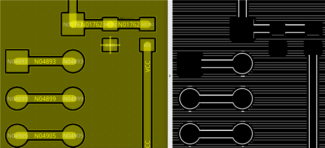

Hello, I am new using OrCad 17.4 and I have been very satisfied with the good performance of the software. I am designing a simple pc board and I want to manufacture it via simple transfer methods (iron or dry film), but I cannot find the correct way to print my design. I go to Cadence Allegro File->Print... but I always get this kind of results (I am using Microsoft Print to PDF):
I have changed my print setup multiple times but I do not undestand the reason why my ground plane is printed as multiple horizontal lines instead of a solid black color, as well as some pads being shorted with the plane. I have also tried Export->PDF... but as far as I undertand, this option is not what I am looking for. I also recognize that I can export my gerber and process it in a different software, but I would like to know if I can avoid that, since I think this should be a simple problem.

    OK you are correct there are no settings for Microsoft Print to PDF. I have CutePDF installed and the settings are available there. It's a free download from the web. You could also try the Export - PDF command which does use artwork films but you can make documentation films of what you need and just export those. There is a preference you need to set (Setup - User Preferences - Interfaces - PDF, set the pdf_filled_shape_transparency to 0.01 and then any pdf generated are solid filled.

    Thank you so much, for some reason I thought that Export -> PDF was only to docummentate and share other information. I checked Filled pads, Filled shapes and Output PDF in black and white mode on my Export Options, as well as I was sure to select my paper size and the scale factor on the page setup. Thanks.
