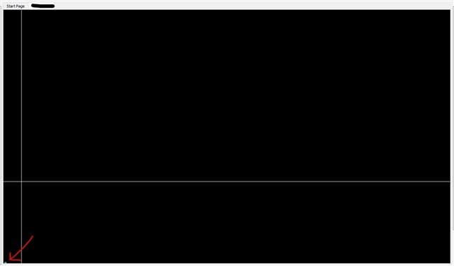

I have entities outside of my title block that are causing my database size to be huge.
I found some but cannot get them all so I cannot change my drawing extents.
In other systems I have used there is a select outside of box option.
You drag a box around your design and everything OUTSIDE of the box is selected then you hit delete.
Anyone have a way to do this in Allegro?

    In the color dialog box enable all colors so that you can find where the objects are then, in general edit enable all items under the find filter. With these settings drag a window for selection and delete the objects outside the title block.

    I already tried this, even when I turn everything on the workspace is so huge that I have to zoom waaaaaay out and you can't see anything.
    I select around the edges even though I can't see anything and I got a bunch of them but the mouse kind of bounces back on the edge.
    I think there are just a few on the outer fringes left.
    It's either by product of translation from Pads or DXF's brought in with the wrong settings.
    The design space is 3,088 x 9,899 inches and the pcb file size is 130,000 kb.
    The blues spec in the corner is my actual C size drawing and I could zoom out one more click.

    I just wrote a simple skill routine to do this, the skill is shown below:
    procedure(DelAllOutsideBox()
    let(()
    (axlSetFindFilter ?enabled list("all" "nodrcs" "invisible") ?onButtons list("all" "nodrcs"))
    (axlAddSelectAll)
    (axlSubSelectBox)
    (axlDeleteObject (axlGetSelSet))
    Then in Allegro I ran:
    skill load "delallout.il"
    skill DelAllOutsideBox()
    followed by 'save_as' and 'quit'

    I couldn't get this to work. I create a file in my env folder called delallout.il and copied this into it
    let(()
    (axlAddSelectAll)
    (axlSubSelectBox)
    In Allegro I entered into the command line
    Nothing happens
    Thanks
  • atoddrich
    atoddrich over 5 years ago in reply to atoddrich
    Ah I did get it to work by then typing in skill DelAllOutsideBox()
    I was also able to re-size my workspace too.
