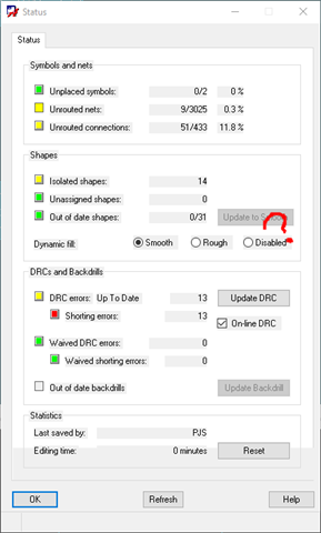

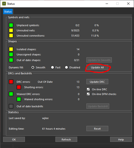

Hi All
17.4 verson has force update button at Status window.
but at 17.2 version doesn't have it.. how to run same function at 17.2 version?

  • B Bruekers
    B Bruekers over 5 years ago
    You can use the skill command axlShapeDynamicUpdate(nil t)

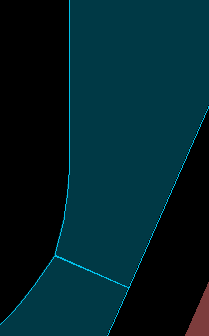

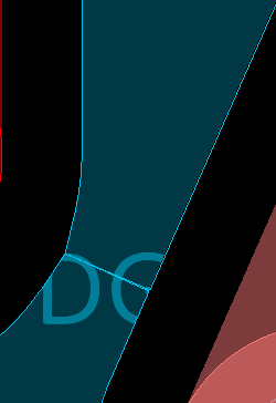

    ichliebedich over 5 years ago in reply to B Bruekers
    thank you B!
    but there is something wierd thing is that if I use 17.4 ver the shape updated well
    but same design is not work at 17.2 version with this skill code
    Is there any sensitive setting for graphic in 17.2 version?
