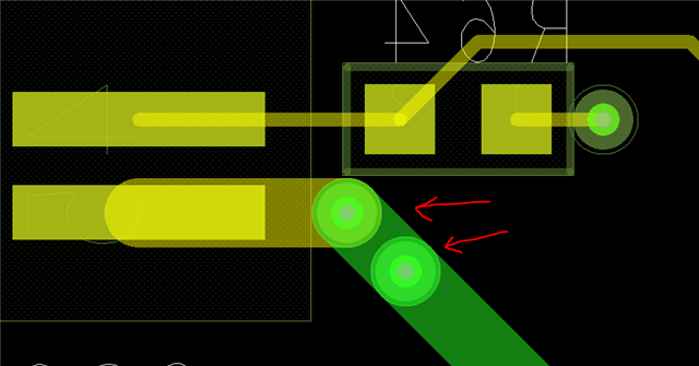

We have some thicker 50mil tracks that need higher current capability.
I want to 'double up' on vias for these tracks, but OrCad won't allow stitching through the board with both vias. See below:
If I try to route both top and bottom layer tracks through both vias, one of the other tracks is always deleted.
This means that only one via is ever effectively connecting the two tracks through the board.
Can anyone help with how to do this please?

    By default, routing Options have Replace Etch enabled which will remove any redundant routing. Get into a routing operation, like Route>Connect, and then uncheck Replace Etch in the Options pane. Note…

    By default, routing Options have Replace Etch enabled which will remove any redundant routing. Get into a routing operation, like Route>Connect, and then uncheck Replace Etch in the Options pane. Note that, unless changed back, the Replace Etch Option will be remembered for future routing operations.

    Worked perfectly - thank you so much for the quick and accurate response.
