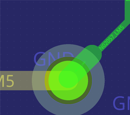

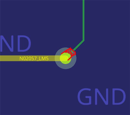

Hi All
there is thin trace which is connected to Via or Thru-Pin which have Anti-pad area.
but the thin trace should be fatten when it enters on Anti-pad Area like below.
Can I control the thinkness of trace in Anti-pad area?
of course if I lay the shape it would be done, but there are so many via or thru-pin should be applied like this.
so I need the function to fatten trace automatically
I want to make all trace like below automatically when they get in the anti-pad area.
below one is that I made manually with cut the single Cline segment
(without Taper/Tear drop)
regard

    steve over 4 years ago
    It's possible but would be a manual operation per via. You would need to draw a Constraint Region around each pin/via then assign a thicker min line width for the constraint region. You should be able to do this to one then copy it to other vias. The only other automated option would be use the fillet command (which you said you didn't want to do).

    oldmouldy over 4 years ago
    If you are really determined to do this, you could "get close" with 17.4 Via Structures, Standard Via Structures are available in all PCB Editor license levels. See this Cadence note: https://support.cadence.com/apex/ArticleAttachmentPortal?id=a1O0V000009MqHXUA0&pageName=ArticleContent
