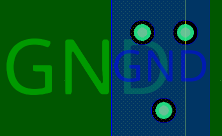

  • G2AS
    G2AS over 4 years ago in reply to steve
    Hi Steve,
    I'm experiencing exactly the same problem.

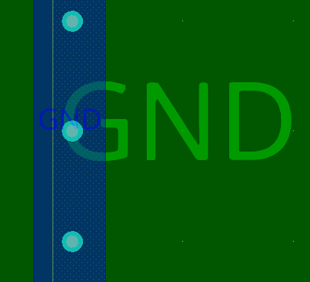

    I have a four layer board with two internal planes, ground and power. I have a module which requires full contact to ground copper to aid the thermal relief.
    I put shapes on the top and bottom planes with the same contact area and stitching vias with full contact to the copper as thermal conduit to the copper plane.
    If I put Via arrays for with GND network, It connects to the bottom GND shape only but voids the GND plane and the top GND shape.
    If I add a wire on top of the shape and add vias manually, the via connects to the three shapes with full contact as desired. I played with ghe global Shape parameters but it doesn't make any effect.
    Left, manual vias added, right with place Via Array.

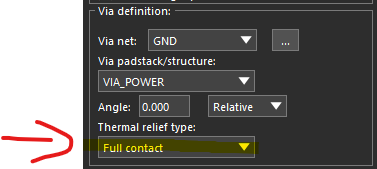

  • G2AS
    G2AS over 4 years ago in reply to G2AS
    Never mind, in my case it was an incorrect setting in Via Array Options!
