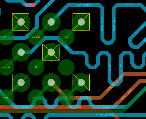

How can I on and off the X box on Power net?
ichliebedich
ichliebedich over 4 years ago
Hi All
it's very simple question. how can I on and off the X box like below?
I don't know where can i find that button
regard
  • steve
    steve over 4 years ago
    Open Constraint manager properties tab and remove the voltage values you have assigned to those nets. They will then appear as point to point connections. If you want the x back you need to add the voltages back in.
