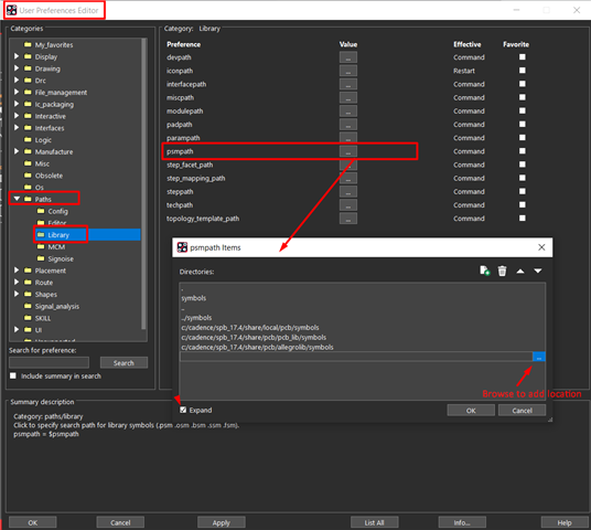

  • mahimag
    0 mahimag over 4 years ago in reply to myil17
    Open your dra, Shape > edit Boundary > pick BOARDGEOMETRY/DESIGN_OUTLINE shape, start editing. Once finished right mouse click > done.
    Save you dra,
    make sure the saved dra and bsm is present in the location specified by padpath and psmpath. (setup >user preferences > paths > library)
    On the board, if this symbol already exists, Place > Update symbol  and you will see the symbol with the changes you have done.
