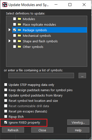

    Can you enable the option "Ignore Fixed Property" before refreshing the symbol.

    Thank you. it worked well. But I am having the following error when I try to update the symbol. Is there a way to fix it?
    6405031A_BRD_02' symbol starting to refresh:
         ERROR(SPMHDB-243): Cannot modify element; the object or a parent has the FIXED property. [help]
         ERROR(SPMHNI-254): Unable to load symbol, '6405031A_BRD_02': 'Cannot modify element; the object or a parent has the FIXED pro~
         perty. [help]'.
    ----- Symbol Update Summary ----
    Refresh symbol errors; due to these errors this design is NOT updated.
           1  errors detected.
           0  warnings detected.
  • myil17
    0 myil17 over 4 years ago in reply to Rajesh3809
    Thank you. It works now.
