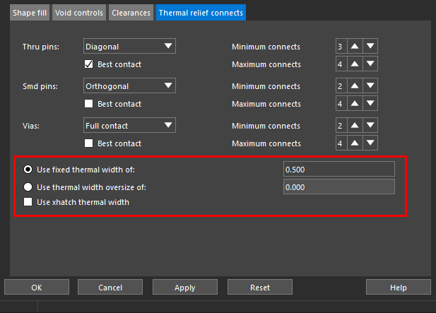

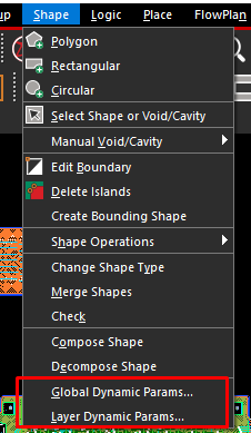

Hi All,
I have a power board that needs x6 thermal relief contacts with increased track size (per the default one)
Where can I change this property to all pins?
Thanks

    Hey there
    If you go to the Shape menu, you'll find the Global and Layer-specific Parameters:
    Inside each of them, you'll see these options in the thermal relief tab:
    This will help you configure the track width you're looking for.
