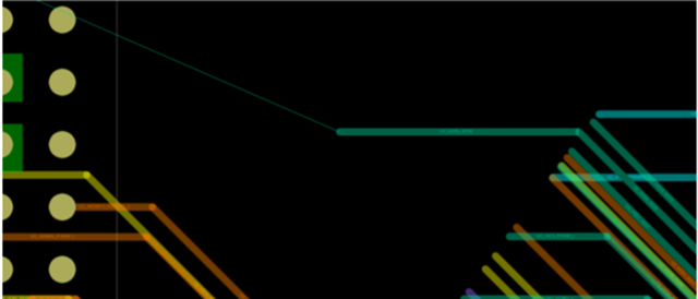

Do you also struggle with rat clutter in your routing area? If yes, this tip will save your day.

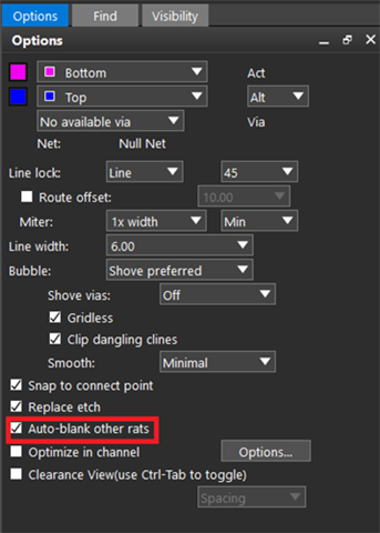

When in the Add Connect command, consider enabling the Auto-blank other rats option. The image below shows a cluster of rats; this is most likely when denser conditions exist on your board design.
With the Auto-blank other rats option enabled, you benefit from the temporary suppression of all rat clutter except for the active net you are routing.
