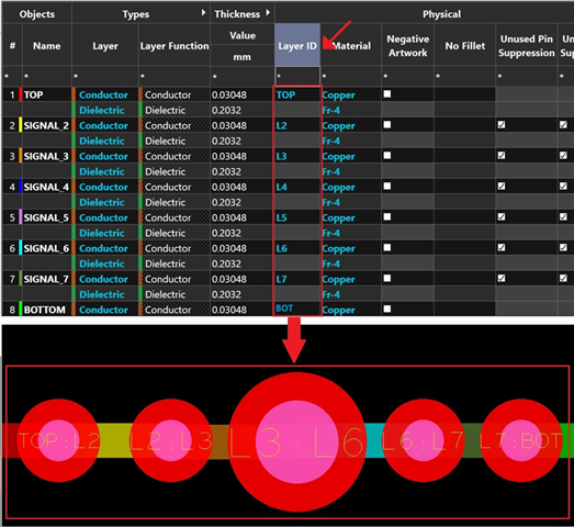

By default, the values associated with BB via labels begin with 1 (top layer) and increase sequentially.
This may cause confusion as labels may be out of sync with the actual layer names. You may consider editing the Layer ID field against the layers in Cross-section Editor. There is a max 3-character limit.
