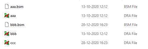

I want to fetch the DRA Names alone in the file directory and list the names in report file. I don't know how to fetch name alone by using skill can any one please help me out.
Here list of library files placed in brd file location in that library files i have to fetch DRA name alone then i want to list in out put file.
output:
DRANAMES.lst
aaa
bbb
ccc
