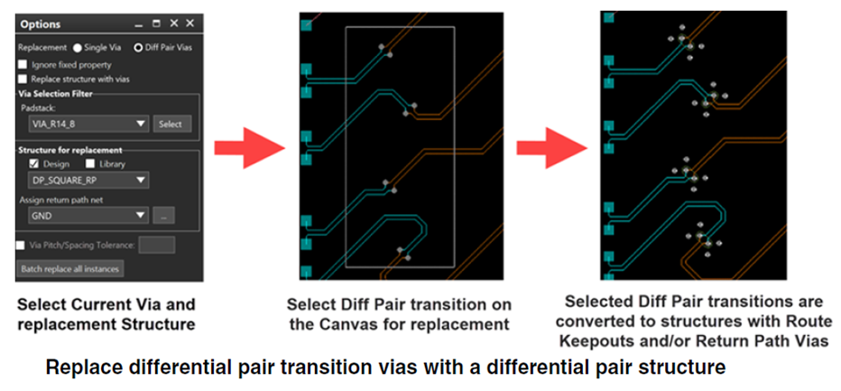

Differential Pair High-Speed Structures
In this release, an automatic method is provided to replace existing differential pair transition vias with differential pair structures by window selection on canvas. This replacement routine requires a vertical differential pair structure, which is rotated and adjusted appropriately while maintaining connections. Also included is an option to convert a differential pair structure to standalone differential pair transition vias when major rework is required.

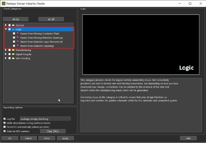

Package Design Integrity Checks
With this release, new Package Design Integrity checks are added to identify the potential opens or shorts for padstacks that have the value of drill diameter set to zero. These checks are specifically for using geometries, instead of drill, on named dielectric layers to define connectivity.

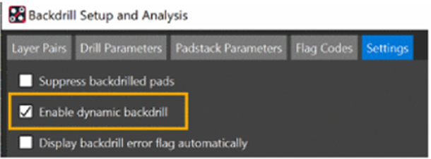

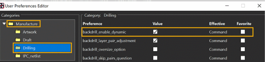

Dynamic Backdrill
A new option is added in the Backdrill Setup and Analysis dialog box that automatically updates pad sizes, generates backdrill, and adds keepouts in the backdrill path when backdrill is run. To see the new option to switch on the dynamic mode, set backdrill_enable_dynamic in User Preferences Editor under the Manufacture – Drilling category.
The new option Enable dynamic backdrill appears under the Settings tab of the Backdrill Setup and Analysis dialog.
