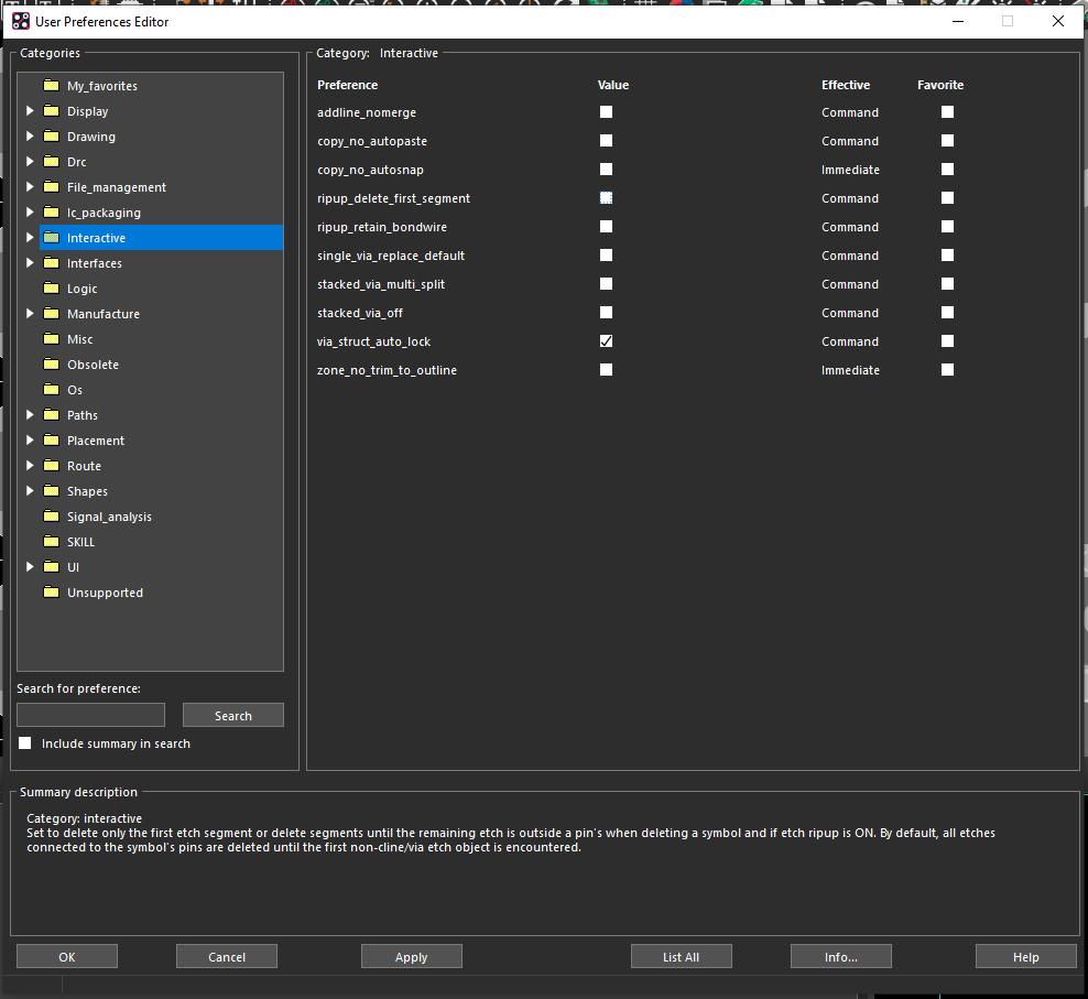

Can anyone help me that how can I add this summary description in my form using skill code in Allegro 17.4.
This summary description becomes visible when I hover on any option.
Thanks
