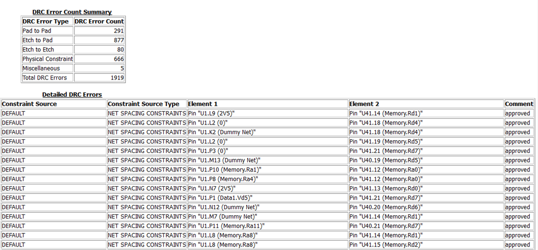

I am using Allegro 17.4 PCB Editor and want to extract my waived DRCs. All my waived DRCs have comments. When I select Waived design rules check report from the quick reports menu I get a report but the comments do not appear in the comments column. I can verify the comments are there using the constraint manager DRC work sheet.
What am I doing wrong?
Thanks

    It's working correctly for me inside Allegro and with the external 'report' utility...
    I'm running the recent hotfix 029, perhaps you may need to upgrade from your current patch level, otherwise I can't give you any other advice

    Works well with 17.2S058 i am using

    You need to update to SPB 17.2 S083. It is works fine with latest patch as attched.
